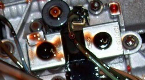

Maybe low on fluid? Fluid need to be changed? Your TCC solenoid could also be going bad. Part pictured below and it's inside the pan and held on with 2 nuts and just plugged in. I know it kept mine from having OD after warming up. TC might be going bad too. Have you had any shuddering problems?
I checked the fluid and it was good although i noticed that the dip stick had rust about 8 inches from the top of the dip stick, so i don't know if water or moisture has gotten in there. Under the car i noticed a milky chocolate colored fluid everyware.
I have noticed a shuttering sometimes when i accelorate from a stop.
