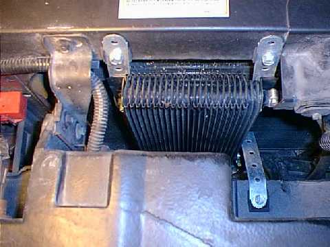

I used the B&M plate style which I think was #70264, and installed it as an inline after the radiator as I live around Lake Erie and it helps get the fluid warmed up in the winter yet also gives it the final cooling in the summer. Here is a pic to show how they will fit under the header panel.
