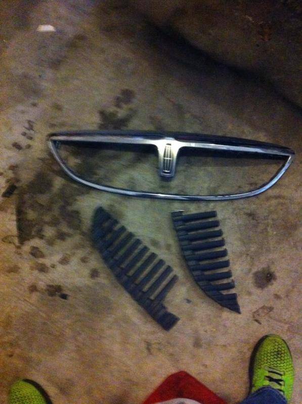

Well I started out with a Gen 2 one piece grille I had laying around and cut the middle piece out with an air compressor dremel tool. Wasn't exactly easy getting all the edge and stuff even, which I didn't. Looks pretty crappy but Oh well. I need to get one I can take apart and paint it then put my aluminum grille mesh in. Going for the mclaren look.. Any suggestions next time? Looks worse in real life than in the pictures!

Did you look for the spot welds? I don't remember it being that hard......
You didn't say what bit you used on your tool, but what might have worked better is a router bit on a die grinder, using a router guide bushing. You probably could have used the outer part of the grill (that you were trying to save) as the template and got pretty flush removing the parts you didn't want. A 2-piece grill would have been easier but good effort with what you had.
A two piece won't have the lower section which is needed for the mesh inset.
Ah, I see. (showing my Gen 1 limited knowledge) I was thinking more about keeping the top part unmangled and not so much about the lower section.
There are 2 piece gen2 grilles and 1 piece gen2 grilles. All gen1 grilles are 2 pieces.
Gen2 1 piece grilles, to get the surround separated from the waterfall, you have to cut the waterfall completely off which wont come out so good.
2 piece gen2 grilles, you just need to cut the 4 or 5 weld spots on the back that are just a melted tab that joins the waterfall to the surround. Grind these down and the waterfall separates from the surround. If you buy a grille from ebay and you need it to be a 2 piece grille for a grille project, make sure you see the back to tell if it is a 2 piece or 1 piece grille.

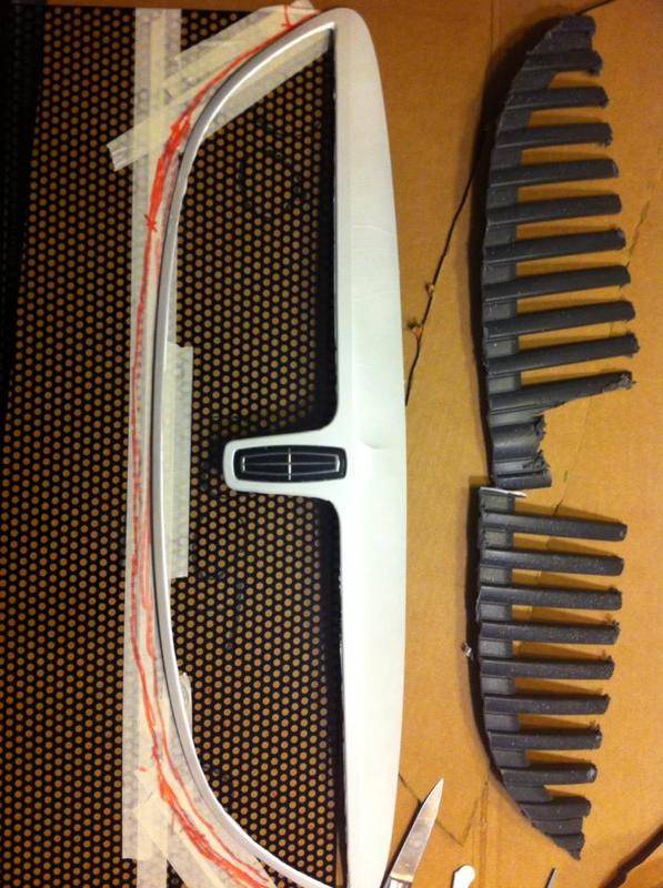

Alax, any experience tearing off the waterfall on a one-piece grille or suggestions?
I'm looking to do what the OP did but with better results. I already got the chrome peeled off and sanded for the surround to be painted, and I wanted to get input on how to cut the waterfall off
Put a flow control on your air line to your rotary tool. If you are melting the plastic you are cutting it way too fast and making heat vs. removing material.
Mk1 Mod0 hacksaw blade about 1/4" away from the good material will cut nicely. Do every other one so you still have some structural integrity as you cut them out. Once the center is gone, layer masking tape over the good stuff and hand file the bad stuff off.
Patience and muscle control are the key. You only have to do it right once.
The only suggestion I can make is, based on the pictures, next time don't cut the entire grill innards out. The grill innards will henceforth be called fingers. Instead leave finger nubs all the way around to both give you a mount point and to give the new grill face some backing. This will also make it stronger, as a ring for the grill face to push against will hold up better than 3-4 mount points would. I'd start by cutting all but an inch to start. Once you decide which ones to actually rivet to, and I would use rivets instead of screws for a cleaner look, you can trim back the remaining fingers even more. On the fingers you decide to use to rivet you can trim them around and round them off to give them a finished look. Trim the rest of the fingers back, but leave enough of a nub for the new grill mesh to push against. Good luck with v2.0.
I did it once. I made a cdc replica grille for a member and when he sent me his grille, it was a one piece. I had to cut it off and then just carefully take off the remaining parts until I had a good enough surround.
The easiest way would be to just buy a two piece grille, shave the 5 tabs, and pull apart for a perfect surround
