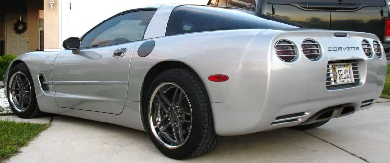

same, 245 on a 9.5 up front. vette.

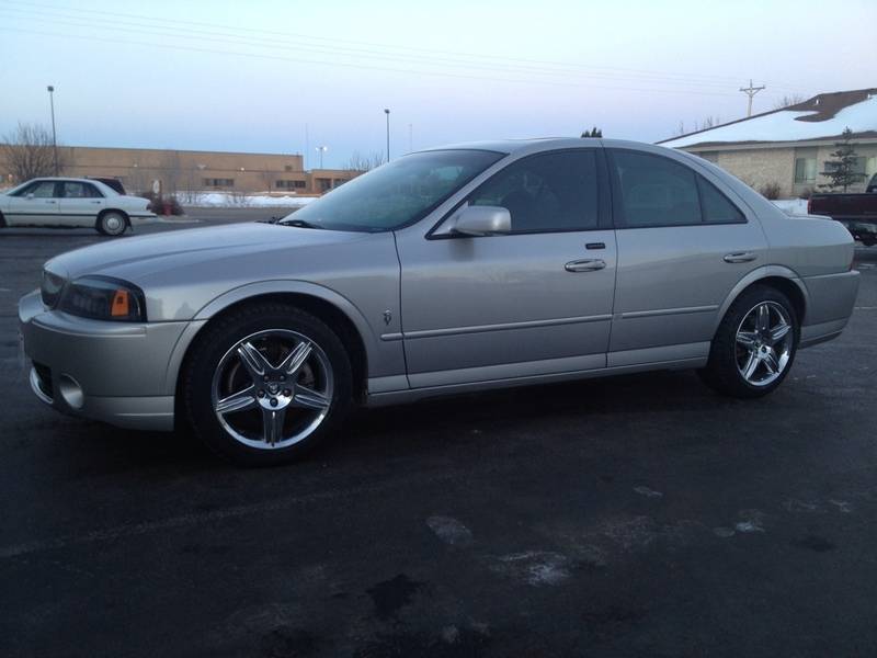

I don't get it. Why? It looks like it would be easy for the bead to dislodge. IMHO looks like those stupid "outrigger" type wheels.
such nice wheels :cool:
now that I see that v8 badge on your car I'm kinda digging it. Do you have a link to where you got it?
1. I already had the winter tires
2. Thinner is better in snow
But it does bug me at times when I look at them so I'm going to keep a look out for a wider pair and replace them at some point.
Chrome wheels for winter, eek. Why not pick up some stockers? Tires are also cheaper and there is a better selection of winter compounds.
Wheels aren't in the best shape, plan in refinishing them and they will no longer be chrome. And like I said, I already had the tires so was trying to keep from spending the money at this time. Right now my money is going to go to a 19" set for spring and then re-do my winter setup over the summer.

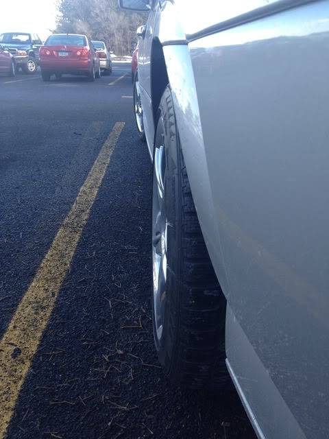

Doesn't look as bad from a better angle
Might be stretching out a bit as well
