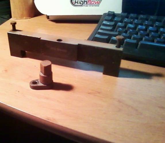

There's a special tool that installs in the place of the crankshaft sensor that locks the crankshaft into the correct position where the flats on all four camshafts are supposed to be even across.
If the driver's side is right, then the passenger side should be too.
Here is a pic of the tools Joe is talking about. The cam holder and the crank postion tool.
