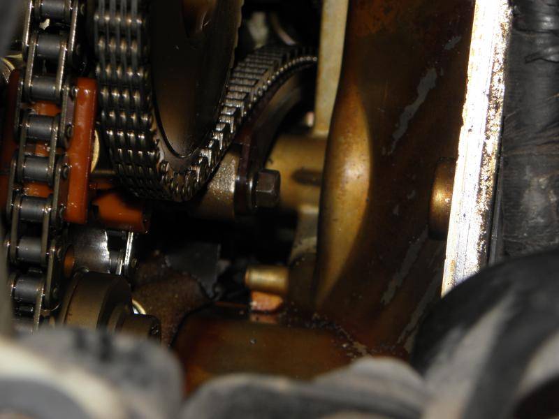

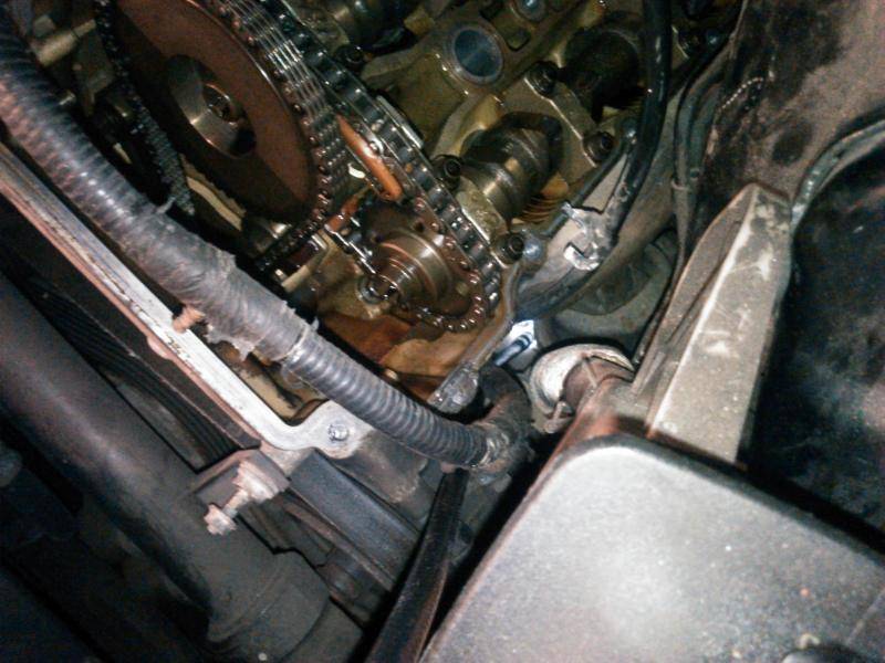

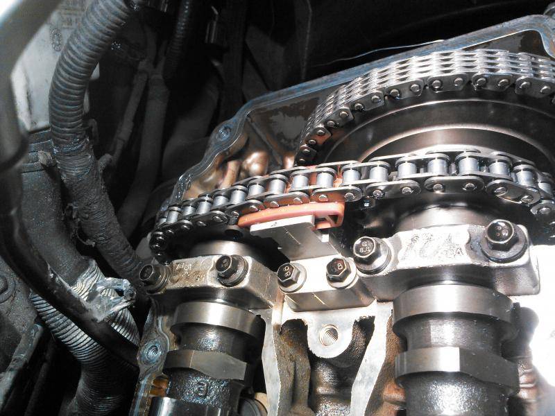

I pulled the driver side cover and... the tensioner is aluminum with red plastic slides (as opposed to either a red plastic body with red slides or aluminum body with white plastic slides). I started with the driver side to get the hard one out of the way. When I revved it, it sounded like the passenger side, but I didn't spend much time at all pinpointing it so as not to risk jumping time. But now I'm worried I misdiagnosed it... I have no idea what else it could be though. I'm going back out to take the passenger cover off once I post this.
Driver side tensioner
Old picture of passenger side tensioner (sort of)

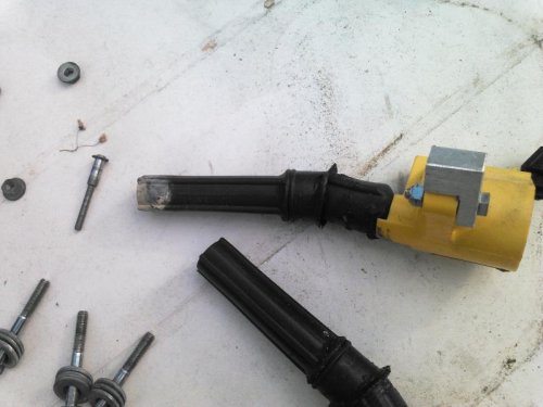

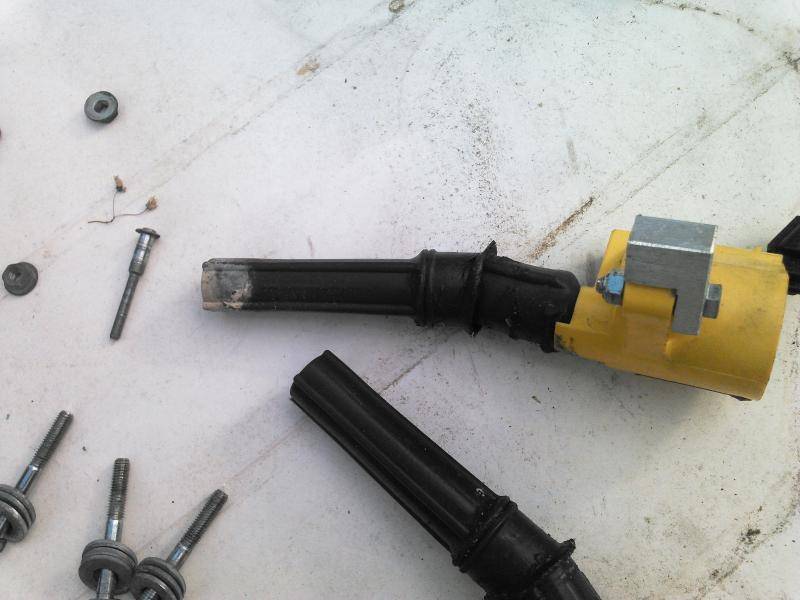

To add to the misery, what the hell is this white stuff? It was in the driver side cylinder, closest to the firewall. Leaking water residue? There is evidence of water underneath the cowl, but the coil boot sealed the well with a pop. It wasn't there two months ago when I pulled the plugs and gapped them...

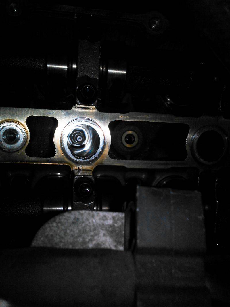

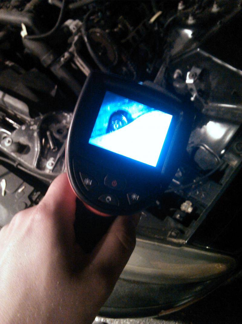

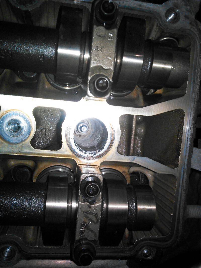

To further upset me, I lost a 1/4 drive ratchet for a while. You know it's bad when you drop it and it slow falls through the bay without hitting the ground. I had to bust out the boroscope. Here you can see some of the head with the drive square facing the camera
See it down there? The little white spec from the scope's lights? Center of the picture

I pulled the passenger side and same deal. Aluminum body, red slides, nothing seems loose. I'm shutting down for tonight to go salvage the last couple of hours tonight with something more fun than this disappointment.
Is it worth replacing the tensioners and chains? Or should I just return them for the $250+. I assume all I can do now is reassemble and try to take a video tomorrow hopefully...

the white stuff is electric grease.
Not impossible, but I disagree. It looks like the typical result of water getting into the well. It's harder than you might think to seal it out. When the engine heats up, air pressure in the well builds and it forces it way out around the seal of the boot. When the engine cools back down, and vacuum forms in the well and it will suck some air or water (whichever is outside the well) back in.
Alternately, if that's dielectric grease, it was cooked by aching between the boot and the well, indicating a bad boot and probably a bad plug.
right - i wasnt saying it was fresh grease by any means, but i've seen it look like that over time.
may not be, either..
I did the Accel installation and ran a year with no grease, then a month or two ago applied black caliper grease to help the boots slide and to help seal it. I noticed on second look that the passenger rear well had a slight amount of white crusty stuff.

I was kicking myself under the assumption I had plastic. No one has reported aluminum failures. Then again, I suppose I might be a candidate for first considering the age. I guess I'll just do them. How do I remove the old chain without removing the main chain? Cut it?
I'm not changing out the tensioners... too difficult. I thought I'd be able to tilt them out from the chain but it appears there's not nearly enough slack to tilt them at all. The main chain guides and upper main sprockets don't move, either.
