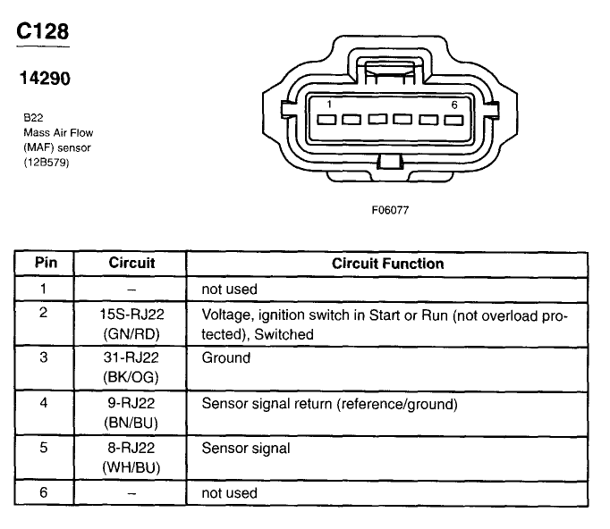

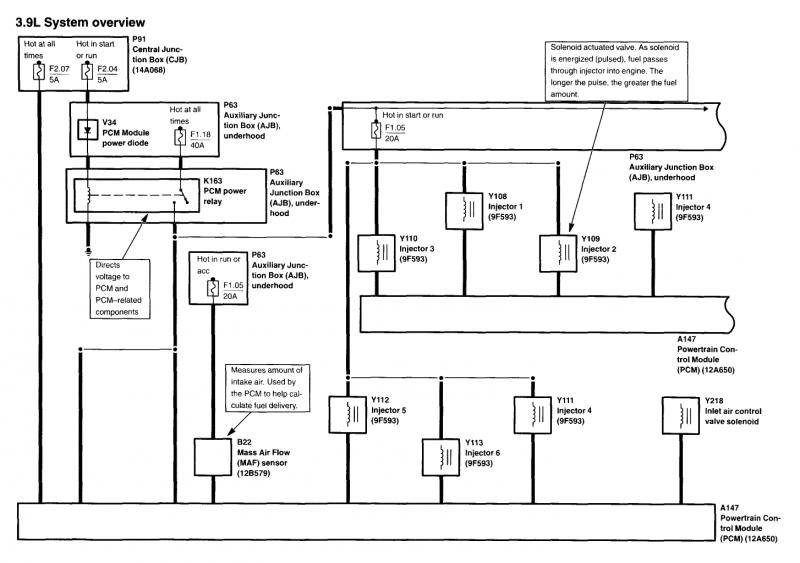

the tool i boirrowed had reading for ST TRM 1, ST TRM 11, ST TRM 2, and ST TRM 21 (and respective long trims). Which I assumed meant pre and post cat. I doube checked the intake and i Don't see any leaks or unmetered air entry points, all 4 O2s are less than 3 months old, but I did see one of the wires plugging into the MAF sensor look a little exposed.. I haven't had any trouble with my MAF - I generally clean it every few months too..
Nick would you be able to get the all data diagram for the MAF wiring? I would appreciate it.
Assuming 2002 ls 3.9;
