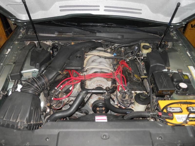

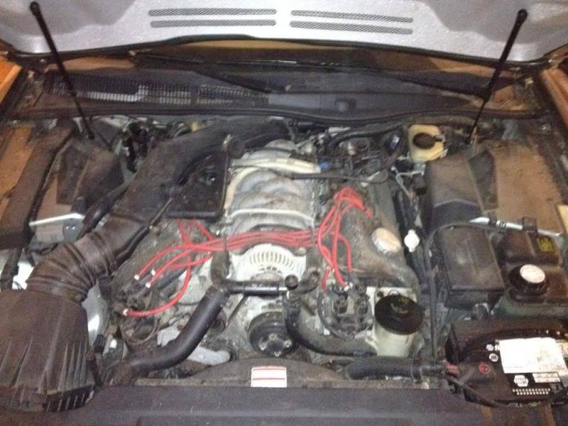

Here is the lowest of low engine compartment pics. From this.

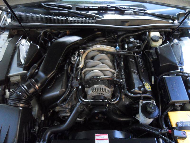

To this stage 1
Ah nice and clean. I know its not a polished whipple or kennebell but clean is nice.
looks good, how'd you do that?...I need to do the same
I took valve covers off one of the 2 Gen2 engines I bought. Those came with all the COPs(8) which you need too. You R&R your old VC's for the newer ones.Kinda tight doing VC's on our cars. You can find tips in my ICE ICE build thread. Then to make swap plug and play I bought a COP conversion harness off SVT site from guy that makes them. Here you can read his post. http://www.svtperformance.com/forum...ug-conversion-harness-new-better-pricing.html
