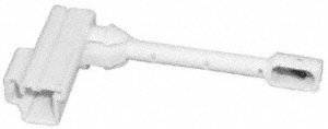

Let's try a wild guess here. On the drivers side of the air box, there are two temperature sensors. Both are white, and both have a two wire connector plugged into them. One is slightly below carpet level. The other is higher. You have to get under the driver's side of the dash to get to it. I think that the 1st gen has a trim panel over the pedals that you have to remove. Unplug the connector to that higher sensor. Now, see if it works consistently after that. If it does, then you'll need to replace that sensor (otherwise the evaporator will freeze over in cool weather). It's a $20 part.
I throw this out there just because the one in my 04 failed about a year ago, and the one in my 06 is failing now. The failure in the 04 kept the AC from cooling much. The failure in my 06 is doing almost exactly what you describe.
This is the part, but you will only see the rectangular part of it. The rest of it is stuck into the air box.

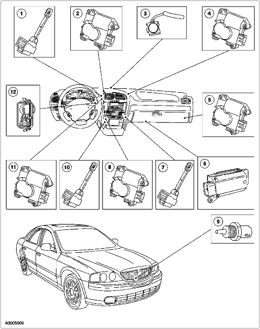

I hope so. Only reference I can find in the DVD to this sensor is on this diagram as #1: As can be seen it shows the thing waaay up
at the center vent level. The other two, 7 and 10, are much lower down at radio or HVAC control level.
I did look on drivers side again and the one I found looks to be #10 as it is appx at the level of the radio/HVAC controls. I stuck my head in as far as I could and I think I saw another one maybe 6 inches further up and a couple inches closer to the firewall. I'm thinking now that is the one I want. It's going to be really hard to get to but I gotta try.
