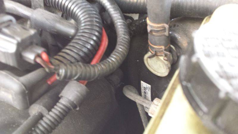

This broke. It connects the brake booster vacuum line to the brake booster. My brakes aren't working right.
What is it and who has it? What years are compatible for parts?
And how to remove it properly?

Any I tried pulling from similar year continental at the junkyard were too small and too short. This has a rubber washer-like ring that gets pressed against the brake booster. I try to pull it out but it seems to have a plastic ridge that's bigger than the hole in the brake booster, but I could be wrong it's hard for me to see it.
For now I tied a bunch of string around it to put pressure on the rubber pressing it against the brake booster. I noticed my fuel economy has been going up too.

it was brittle and snapped when i was takingnit off. The rubber boot was already broken. I cant drive to work without this. Does anyone have this piece? It has a rubber boot around it, that's why the neck is longer

The malfunction was that it broke and the replacement pieces were different. (see picture)

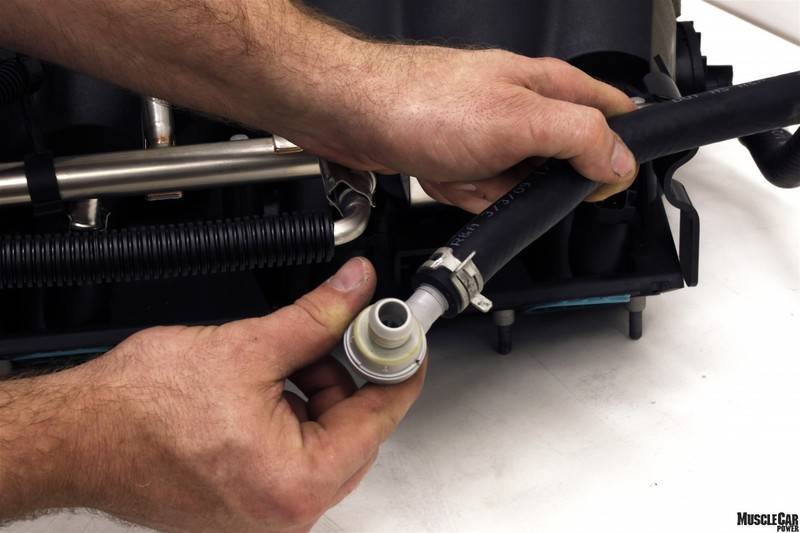

It fit together like any other car with a check valve. The only difference was this one was a little longer. *googles pictures*
This:
Fits into the grommet:
^ ^ ^ ^ And the end result is the picture from my first post. ^ ^ ^ ^
The rubber grommet need to be squished a little to get it secured, as the way it gets secured is the two outer rubber ridges are bigger than the hole size. It holds it kind of like a sandwich. When i put it, I was able to give it a quarter turn back and forth with my finger to make sure it was sitting correctly.
