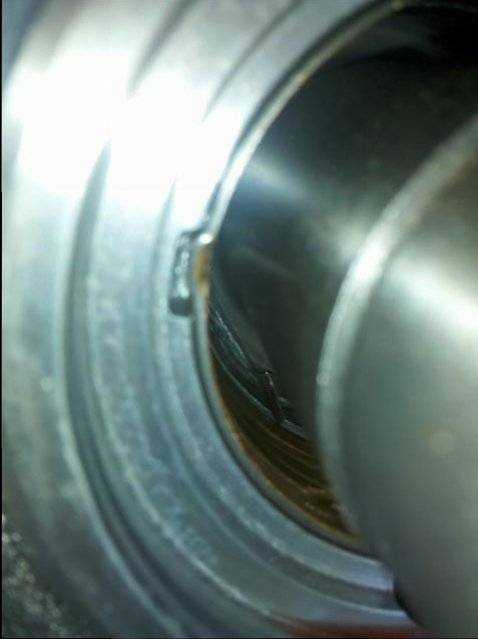

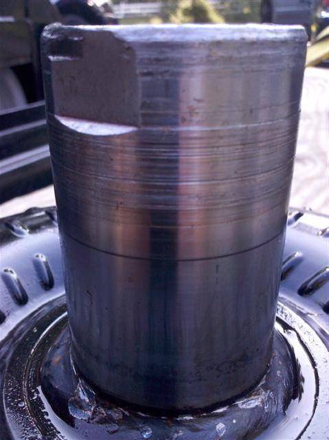

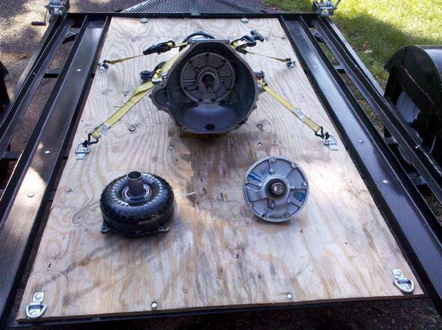

So this week I cleaned my garage because I wasn’t going to do another transmission R&R in the drive way again and tore into the mark Thursday night. Seeing as I have done this a few times it did not take very long to extract the transmission.
Slowmkviii and I got the Trans out and pulled the converter off and you can see what we found.
The Torque converter is an Edge 10" 2800 stall but since the trans was misaligned due to a chewed up alignment dowel (we are talking about 2 mm misaligned, so not much) it knurled the pump and the end of the TQ shaft.
I have another pump already from a parts transmission so that is no big deal to replace but I had to send the converter out to be rebuilt ($250) with a new shaft. Since there cutting it open they will be losing up the stall to 3200 as well.
Friday I should get the converter back and hopefully next weekend I can finally drive it for the first time in 3 months. Lesson learned DO IT RIGHT THE FIRST TIME IF YOU CANT DO IT RIGHT THE SECONED TIME! I have done about 20 transmission R&R but I was rushing to get this one done by myself before a car show and now I am paying for it. So learn from my mistakes.
