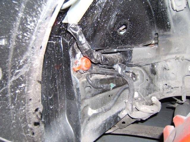

Your LS has a extra battery post hidden in the front passenger wheel well behind the plastic wheel well liner. Don't get confused and look on the drivers side as that throws people off too.
Now listen to this next part real close!
DO NOT jump your car from this post!!!
It's only to supply 12 VDC to open the car and/or the trunk so you can access the rear mounted battery to start the car.
Here is what it looks like;
So don't despair you can certainly open the trunk next spring!
