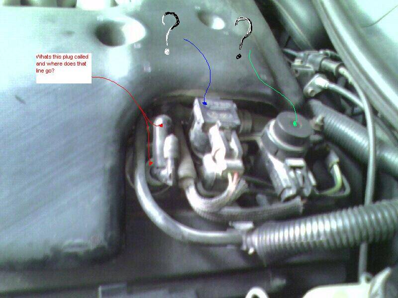

Wat parts are we looking at?
94' mark 8
one is the egr vacuum solenoid, and the other is the IMRC vacuum solenoid, im just not sure which is which, i think the left is the imrc and the right is the egr
As others have stated, vacuum cap is on the pcv valv. Blue line goes to the IMRC actuator vacuum solenoid. Green line goes to the EGR vacuum solenoid.
