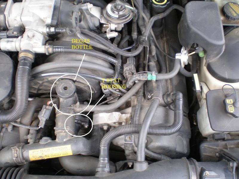

Here's a pic showing where your thermostat is. It's the second hose down from the engine fill cap (labeled degas bottle on the picture). 3 bolts and that's it. Can't remember if you need the gasket or not. If there is one, make sure you replace that as well. If you need to, you can remove the intake tube to make everything easier to access. disconnect the tube from the airbox and throttle body, remove all electrical connections from intake tube, and remove tube. :

Dude... this takes less than an hour. The book that the garage uses says you have to remove the intake manifold. No idea why it says that. You do NOT need to pull the intake manifold to change the tstat.
However, if you are skeptical of doing it yourself, you probably are better off paying someone to do it. FYI it cost me I think about 30 bucks when I did it myself. Could've been less. I can't remember the price fo the tstat/gasket
Took me 45 minutes to do, whoever said it took 4 hours must've been doing it with 1 arm... and on drugs.
extremely easy to do. And you may need to perform the bleed procedure several times to get 100% of the air bubbles out of the system. Otherwise, you may get random overheating situations. Just watch the guage...if it begins to creep 3/4 or higher...put the heat on full blast for 30 seconds or so. That usually dislodges the air bubble.

thanks for everyones help.The thermostat change was easy.
I wonder if the dealship really would have taken my $700? It only cost me $40! :D
I am not sure if I did the air bleed correctly because I could not find any of the values. But it doesn't over heat anymore.
