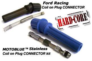

yeah I've done both, but I mean the electronic part that connects to the harness and the boot and coil connects to. When I ordered from RPM Outlet they included everything, but that so now I'm looking for the "connectors" atleast thats what I think there called.
I think that might be the issue... Is this common?
this is what I changed.
I'm wondering about the top part the coil and boot connects to then you attach to the wiring harness to it.

From that picture you posted, you only replaced the connectors and boots, not the coils themselves (which is what I think your talking about with the other connector/'electrical part' you mention...)
