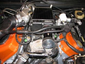

looks good...which snow meth kit did you go with? I'm only running 8#'s on my 2.2 k/b b head with 310rwhp for break in. I'm going meth and 15#'s after break in and was looking at the stage 3 gasoline boost cooler. I can't believe you got that thing under the hood. here's mine! I still have alot of cleaning up to do.
