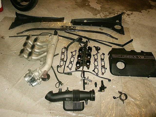

It's a much bigger job on a V6 due to the intake being draped over the right side of the engine. Here is everything that must be removed to do the job.
by the way, have new plugs put in and make sure that you get all of the coils on the right side replaced.. Considering that you have probably just one bad coil, you will now have 2 good used spares, and they will be able to replace the left side of the engine's original coils, which would be your most likely next coil problems.
Get a new PCV valve and hose put on while it is apart, since that stuff lives under the intake and fuel injector assembly. You should get close to another 100K miles out of it without taking that side apart again.

Plugs are $30 a set. PCV valve and hose are $35. I got coils at autozone for $40 each. Their system comes up with the wrong part numbers, though, so if you try this, and you want to get those coils, I can give you the numbers. It is a large enough job that you should have some comfort level with a lot of aspects of auto service to dive into this. You would want to have tools, know-how about how the ford connectors work, so that you can successfully get them apart, and plenty of time and documentation. The old intake gaskets will set you back an hour or so getting cleaned up, because they will be all flakey with carbon build-up. Use spray intake cleaner or similar. Stay away from brake cleaner, it is probably too strong on the gaskets, not to mention your hands. Use blue or purple nitrile gloves, they stand up to the solvents pretty well and leave your hands pretty clean after almost any job.
One point of advice: if you pay someone else to do this, you are looking at a 4-8 hour job, depending on problems encountered.
The metal brace for the firewall to each fender that hides under the cowling that the wipers come out of, tends to twist off the bolts, so be prepared to drill out bolts and possibly tap new holes for new bolts.
