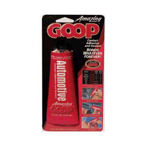

When you're ready to re-assemble it, some Goop adhesive will work. If you ever need to take it apart again, the Goop will loosen at 150 degrees.
It'll be easier to reassemble this way than cutting it up.
BTW, when you glue the lens back on, be sure to use something to hold the pieces together tight. The Goop may try to force the pieces apart as it hardens.
I used duct tape, and wrapped it so that the parts were held together very firmly.
Remember to use the sealant around the entire area where the parts mate, so you won't need to worry about annoying leaks on rainy days.
