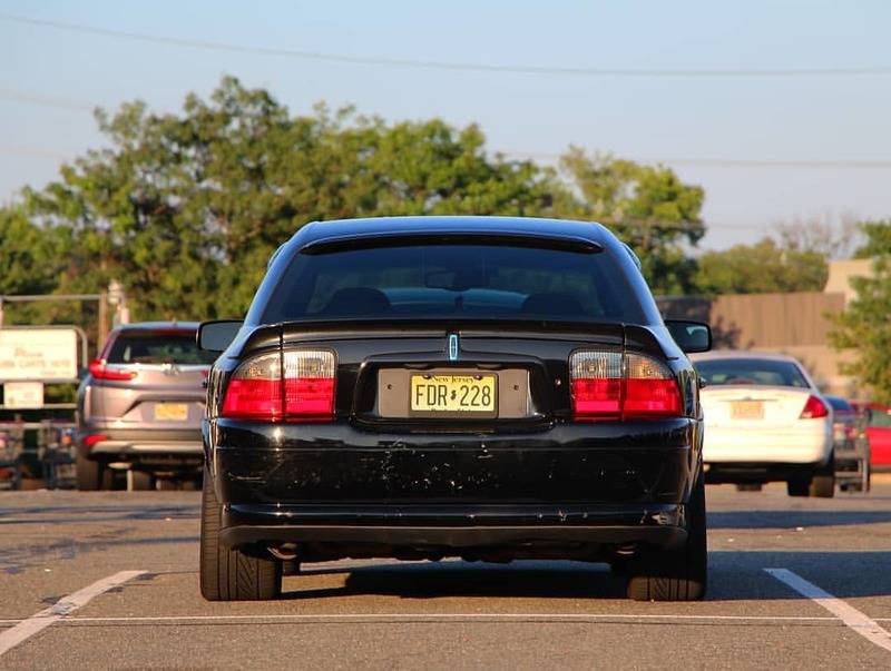

Quik did, Manoli and Jason have them. Not sure if anyone else. And myself :cool: Well, inners only
n.jpg?_nc_ht=scontent-lhr3-1.cdninstagram.com&se=7&ig_cache_key=MjA5MDAzNDc3ODQ3Mjc1OTU0OQ%3D%3D.jpg
