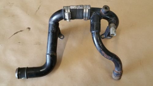

    I did find this croosever tube off of a 2003-4 cobra that had a turbo for $100. I really don't know what problem I am looking to cure....
