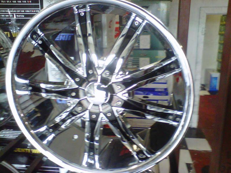

by the way D_kelly.. lets see a straight on pic of your LS...how the heck do those wheels not rub? the r freaking huge

straight pic... you mean without the rims? I just bought some new rims.... let me know if you like these... and yeah I know its an STR 8... I'm pretty sure my car says it... I'm at work and I have to make these posts quick
in your album, it looks like they stick out alot...I wanted to see how much they stick out.

oh I don't have those rims on there anymore... it was winter and I live in Wisconsin... I had to put my stocks wheels and tires back on for now.. it wasn't too bad I kind of like it actually. instead of an 22 X 8.5 they were 22 X 9.5.
