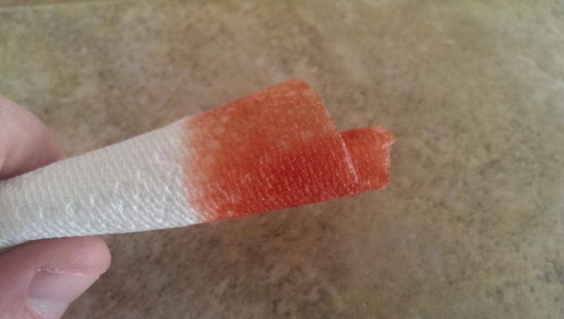

What does the fluid in the reservoir look like?
I do not think I've lost the boost entirely. I haven't tried steering the car while rolling with the engine off, but when I lost p/s on my previous car, it almost required two hands just to turn the wheel. It's not nearly that bad in this case.
The fluid looks like this:
Well, I think that it could be the pump, boost solenoid actuator, or the rack. Since the pump is making noise, it does point to the pump.*
