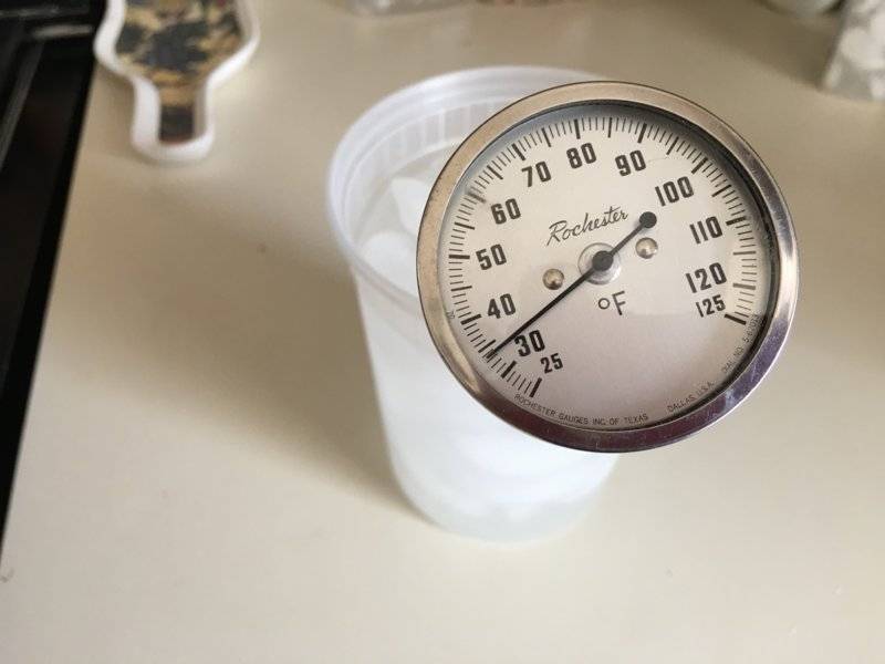

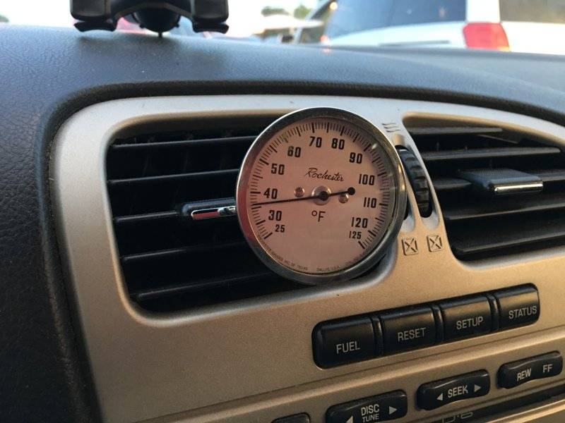

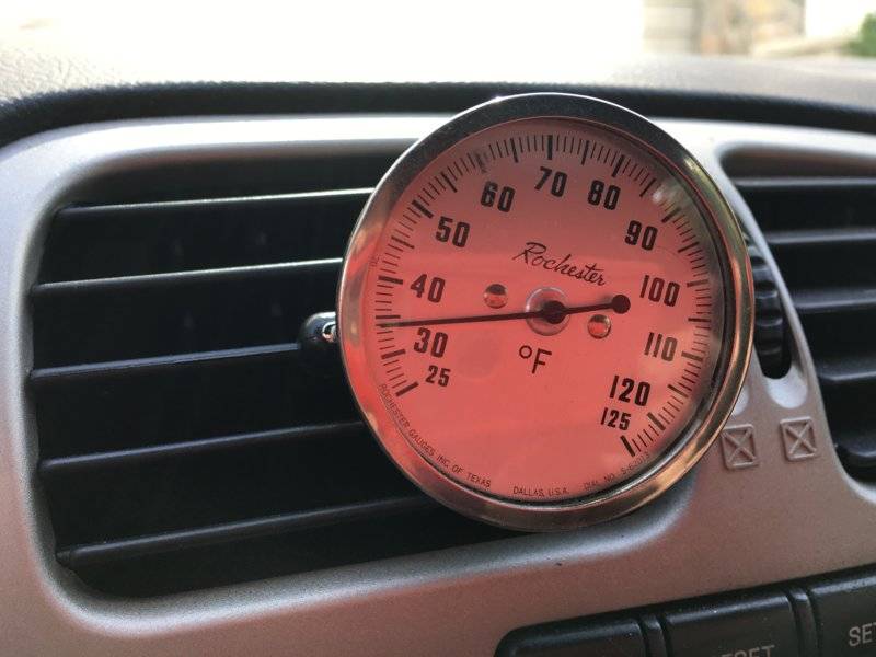

Picture from last night, this morning, and cal check. It's off by 1.5 degrees. I've never gotten an A/C this cold.
