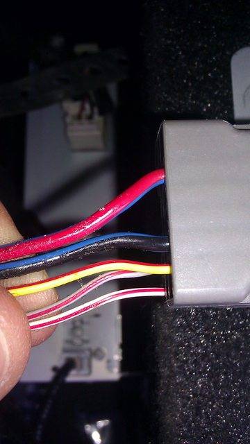

Can anyone tell me which one of these wires is the Remote wire for the factory amp? (This is the wiring harness coming from the head unit to the factory amp.)
From the top:
RED/BLUE
BLACK/BLUE
YELLOW/RED
GRAY/RED
WHITE/RED
i can bet you its not one of the top two, would need a meter to tell you witch one of what left
From the top:
RED/BLUE
BLACK/BLUE
YELLOW/RED
GRAY/RED
WHITE/RED
If you read the thread I posted a link to, you would see that it is the Yellow wire with red band. (No more spoon feeding after this...)
I agree with that. I have a meter, I just need to turn the radio on and check for 9 to 12 volts?
You're only going to get 6 to 7 volts on the turn on wire. That's also in the linked thread.
I apologize, I am on a smartphone. It's not fun to navigate multiple threads. I appreciate your help, joegr. It shouldn't cause you so much heartache to give help on a forum dedicated to the LS. If you were so upset you didn't have to reply to my questions :p
**Anyone who was curious, my system was triggered just fine by the remote wire that was pointed out by joegr. I have a BOSS Audio Phantom 2000**
