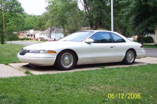

Just my two cents worth.. I've owned 3 Marks now, all of them getting Strutmasters kits. My first 94 I bought the lowered kit. Well, after some time on the springs, say 5k miles, they were no longer a 1.5" drop. It was closer to a 2.5" or more. These springs do compress some with time. My recommendation is to go ahead and just buy the regular height kit, and drive on it for a while. Then go have them lowered how much you want. Then they should stay put. The picture is of the 94 right before I sold it.
I was one of the last people to get the lowered kit from them and the picture above is exactly how mine sits now. Its been on for about 5 years now, i bottom out over every speed bump if i dont creep over them. The picture in my sig was just a few hours after i installed them.
