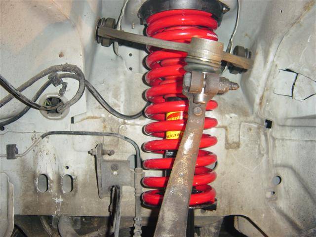

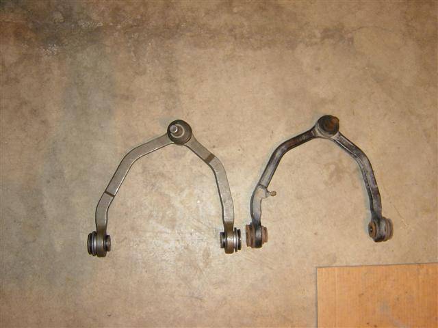

Yep they came today-missing a rear top plate:mad: but its on its way.-I picked up new a-arms today also,but didnt feel like dicking with it today-I found that enlarging the hole on the drivers side made getting that bolt simple.So its all ready to install,all the old stuff is out.I got the regular height kit and they are the red ones:D
Ok all done-ya know the backs were a bitch to get slid in-Glad I got the standard height as it sits perfect for me:rolleyes:

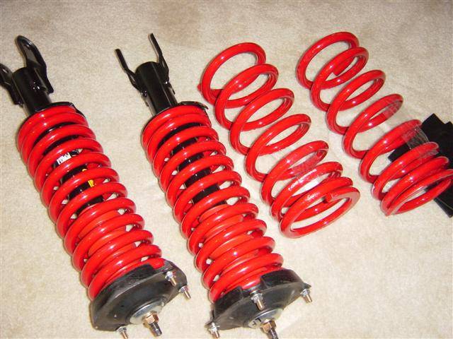

Ok sorry for the delay,here are the pics

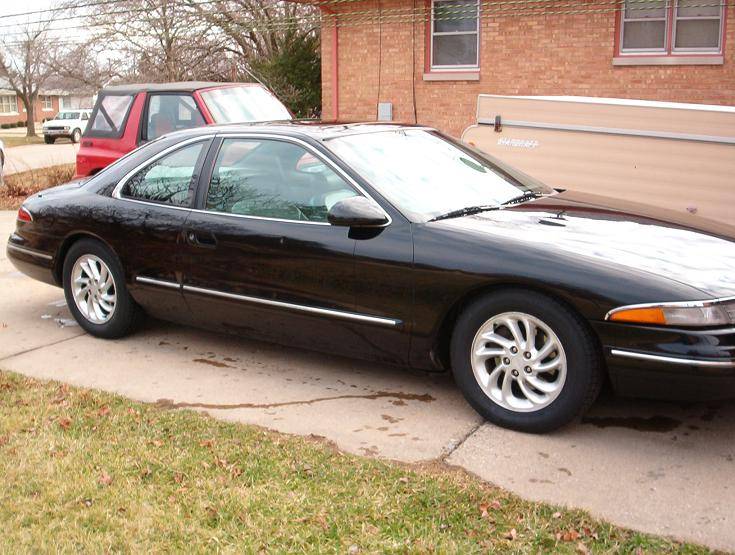

My tires/rims are too wide-cruising on the expressway and hit a dip and you hear the crunch sound from the tire hitting the black plastic protector.All good now :)
Here is my 1.5" drop kit about 3 weeks after the install. It has sat for most of that time so I haven't driven it that much.
