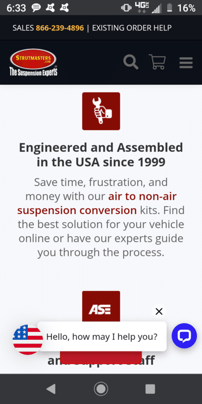

Well I hate to burst your bubble... but I doubt the springs and other components are made in USA.
Screenshot from website:
I doubt anything is made in USA from strutmasters.
FYI... I just found THIS.
