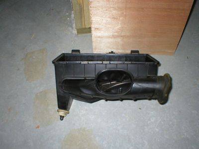

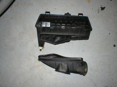

You might want to look at TECH ARTICLE, Modifying the Lincoln LS Air box.
What Im talking about, is instead of making a heat shield and routing a tube to it, just rout a tube to the hole in the factory box where the baffle goes.
But the tech section does have a good mod on cutting the bottom of the box. I think this guy is just talking about removing he baffle.
Hey, gcwimmer, my air box looked nothing like this! It just had one single baffle tube.
Whats with that?

No no I said sorry as in sorry I did not inform that I have a 1st gen V8:D
I was simply hoping that you would have a clue as to why the box is different.
