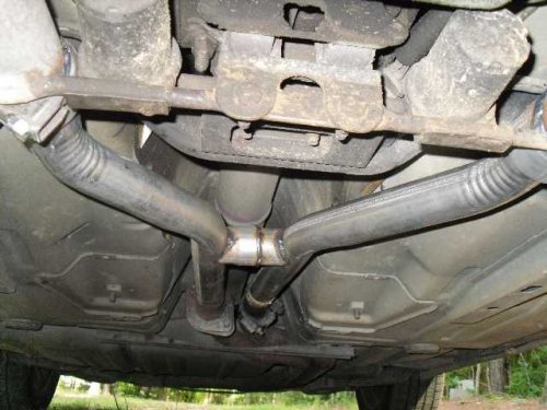

Removed 3rd cat and replaced with H-Pipe. No more stink!! Yay!! :)

It doesn't do it anymore since removal of the 3rd cat. Before, it only smelled bad after a WOT run like passing somebody. The cats have 177K miles on them. I'm surprised they're not completely stopped up. But the biggest surprise was the gas mileage increase. It is truely amazing what a difference it made in the entire character of the car.
Here's my H-Pipe.
Ain't it purdy?:)
They were probably partially stopped up. This may be why you're getting better fuel economy. With the new exhaust setup, what effect does it have on interior noise?
Of course it won't smell without them, theres nothing there. It's still running rich most likely though...
It's loud.:D Really, not bad at steady highway speeds, though. But at takeoff and any time you give it gas to speed up, it gets pretty loud. At low speeds around town there is a drone. Not anoying, but actually quite pleasant. I like to hear my engine.
