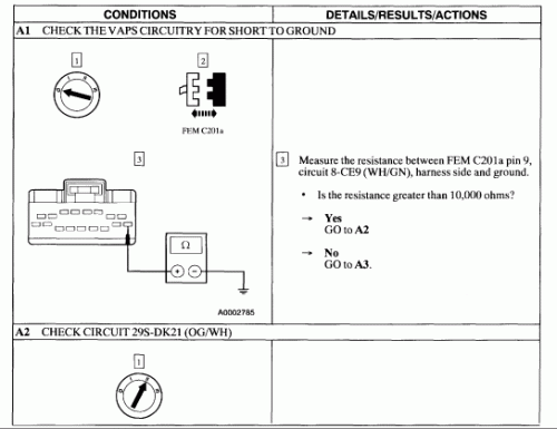

Figuring they called it "A" for a reason, I started with Pinpoint Test "A":
Step A1 -- No continuity at all between Pin 9 and ground, so I go to step A2.

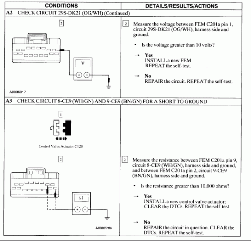

Step A2 -- With ignition switch in "Run," I get +11.55V at Pin 1.
Yikes! It wants me to replace the FEM!

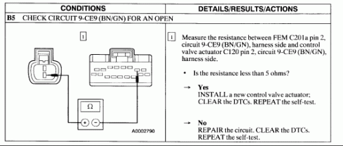

So I move to Pinpoint Test "B":
Step B1 -- With ignition switch in "Run," I get no voltage at Pin 1. On to Step B3.
Step B3 -- With ignition switch "Off," I measure about 7-8 ohms between Pins 9 and 2.
This suggests I need a new P/S actuator, and if that doesn't fix it, then a new FEM.

Another question for those who might be more familiar with Ford's diagrams: Step A1 in the first diagram (for example) has pictures indicating that you should first turn the ignition switch to "Off," then disconnect FEM harness C201a, and then take the specific measurements described under step 3. Step A2 has pictures indicating that you should turn the ignition switch to "Run" and then take the described measurements, but it doesn't give any specific indication about the state of the C201a harness. When I did these tests, I interpreted this to mean that the C201a harness should remain disconnected as it was in Step A1. Is this correct? Or does the lack of an instruction to disconnect that harness mean that it should be connected for that step?
