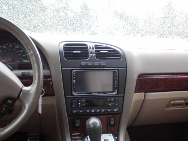

I just installed aftermarket cd/mp3 player in my ls. Let me tell you it is a major PITA!!!!!! This was the most difficult install out of any car i've owned. I got the proper wiring harness and dash kit but when all assembled the heater controls part sticks out further than it did stock and what our tech articles left out is that you still have to use the factory metal dash brackets that came from factory radio onto your new plastic in dash kit. if you do'nt then the heater controls won't be in dash securely and it will fly out! My car is 2000 ls v-8 without alpine system with 6 disc changer in glove box. This was a total nightmare although my stereo sounds 10xs better my dash looks stock but if you know what its supposed to look like you will notice the heater control flaw of it sticking out beyond the ash tray and heated seats buttons.
This was a single din unit? Metra makes a kit that works flawlessly without the factory brackets. You should try a double din install, then you'll really know PITA!
Oh, I should add that the plastic brackets that come with the metra kit bolt onto the climate control unit, so it doesn't "fly out." Which dash kit did you buy?
oh ,sorry forgot it was a single din with removable plastic pocket. i got it at millionbuy.com it was scosche LN1328 wiring harness was american international #598. pektel my stereo dash kinda looks like yours at bottom but not sure. is the heater controls supposed to line up straight with stereo and stick out a couple inches from the ash tray? maybe i'm to picky or it is correct,but i swear stock was flush at bottom. LOL! cheapest price was at million buy and crutchfield wanted a price for install kit which costed me more than the harness and install kit i bought at million buy put together. sry for rant but i was aggravated and just finished installing it and it took me forever to do. LOL!
yes there are 2 bolts behind ashtray. i just mounted my stereo w/install kit and placed climate control under the pocket and removed the factory metal harness and fitted it behind my new one. my install kit didn't include any brackets or pieces for climate control. everything sits flush but to me the climate control's bottom sticks out a couple inches from the ashtray and heated seats switches. but looking at your picture it seems like mine looks flush like yours but i can't judge the bottom part to know for sure. Only thing i don't like is i can move climate control by hand but at least it won't come out...haven't driven car yet to see if bumps or vibration will upset or misalign anything. I just love fact that now i can play mp3 cd's instead of a million regular cd's. My project for tomorrow is the lovely driver's side window regulator! Paid 65.00 for after market on with motor included. dealer wanted 150.00,i said what are you nuts?

sorry rick no pics but as far as inches not very much but to me seems noticeable. maybe its just me like i said from blowing a gasket while installing this! LOL! All i mean is that the climate control is flush with stereo but not with ashtray and the wood surround.....was it from the stock radio? I'm so confused now. Anyway everything works great and drove car over bumps(after all i live in pa,worst roads ever)and the climate control didn't move and nothing got misaligned. The girlfriend didn'y notice a difference so i'm not going to sweat it anymore! It works and sounds great so good enough for me! maybe while i tackle the window regulator i'll lokk into changing the speakers if they haven't been already.
i have used AI and scosche kits before and they both re-use the stock metal bracket and the fitment was less than desireable because part of the metal bracket overlapped a plastic bracket and it was just to thick one one of them the other was just crap, i currently use the metra kit and it fits a lot better(sorry i dont have the part number this time) and it has its own brackets that screws into the climate controls and is very firm once bolted in at the top and bottom. now only if someone made it in silver.
