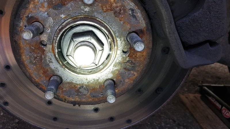

    Investigated further, it appears a hub can be bad even with little or no movement. I checked the play again and one side has none, the other does have a one or two mm and upon full rotation I can hear a grunt when spinning 360 degrees at the same spot. This could be rotor/pads though.
    Odd you can see the ball bearings and couldn't see grease. So i packed it with wheel bearing grease as much as i could without removing - i understand these are one time use spindle nuts on the front?
    Read here that some members have bent back the tabs on the nut to reuse - although it was an old thread. Is this an option? If not does the nut come with the hub or do you have to buy seperately?
    Any reco's on which brand? I can purchase at rockauto $71 each+ duties + shipping, but think it may be cheaper to pull hub and take to a machine shop and press out bearing and replace. Any thoughts?
    My front rotors are 1.5 yrs old, that rust is from the salt they put down for winter.
    I will see if the grease stops the tiny new hum and rarely accompanied pulsing. I didn't feel any grittiness to the hub, so not 100% what is causing this rare occurrence.

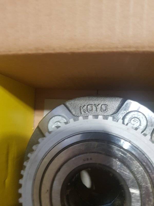

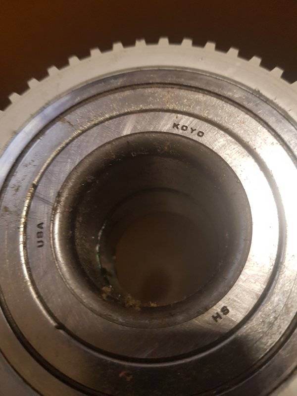

    So I picked it up and the Moog part isn't Moog, it is Koyo branded inside a Moog box. Do you guys think any good? Bearing is stamped Koyo USA. Researching I found many saying this is a good bearing (one of the largest companies). Even saw one person say their Timken part came with Koyo bearings - this was on google, not this site and always value your guys opinion.
    Timken here is $152.55 with our 13% tax. Not available at RockAuto - they are at Partsgeek but they don't deliver to Canada and 70 usd with USA shipping $10. The Moog was only 82 CAD w/tax, which is the first part I've saw in Canada that isn't twice as much or more as the same part in the USA.

    I've used koyo in the past with no problems
    I like timken most but from rock auto I had 2 fail in a row timken box but the bearing was not stamped with there name
    So possibly a fake?
  13. germansheperd
    germansheperd Active LVC Member
    Messages:
    161
    Likes Received:
    25
    Joined:
    Jun 1, 2016
    Location:
    Wooster, Ohio
    Koyo is a very high quality OEM Japanese manufacturer. The Lexus, Toyotas, and Hondas ive had in the past were as smooth as glass and never had a bearing failure.
    I’d run that bearing no problem.

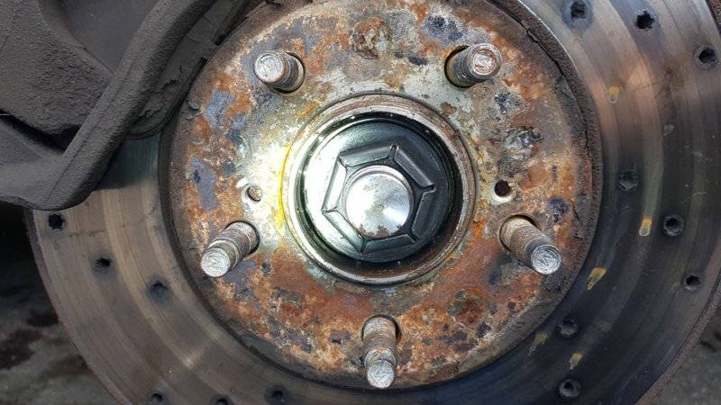

    So it was the hub. Any of you get a hub without grease? My new one looked like the old on the inside - didn't see much grease at all and can easily see the bearings.
    While researching, i found this on another forum post 8 of 17 states:
    Check them closely; The ones I just installed from advanced were not greased at all.
    Front hub/bearing - do I need a puller to remove? 1992 - TCCoA Forums
    Picked up a spindle nut at Ford they wanted $17 and sold it to me for $14. Part Source wanted $40 for the nut!

    So any of you get a new hub without grease? Or do they all look like pictured above?
