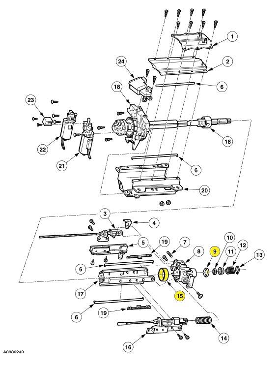

Also I've hearing a crack like noise when turn the steering wheel, and it feels somewhat loose, so I took apart and find out that the upper steering column bearing is falling in pieces, did an exhaust search but not found anywhere to buy it, did any of you already change it? See the pic... :confused:

I'm pretty sure you have to buy the whole column to get that bearing.
Try craigslist you might get lucky
I've seen ads for a whole Ls being parted out
