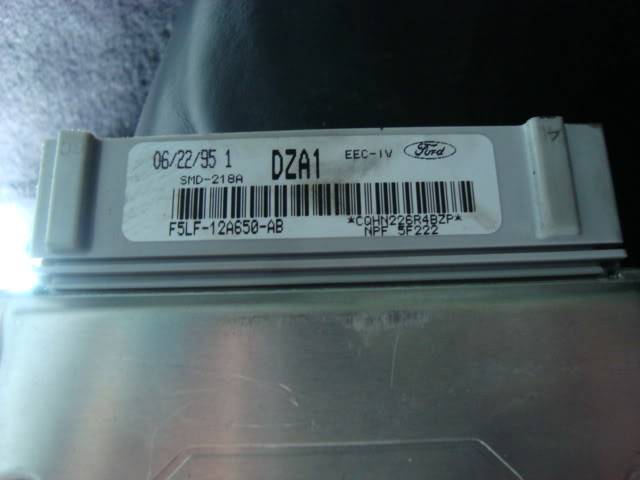

That's where I would start. You can use a W3Z2, DZA1, Z4HO and possibly a W3Z3 so that's the ones you want to look for. You can't use one from a 96 at all. If you want me to and (if you'll pay for the shipping both ways), I'll send you a DZA1 for you to try and if that fixes the problem, then you'll know what you need to get but I do not want to sell mine. I will however let you use mine to either find out if that's the problem or eliminate it as not being the problem. The one I have is good, I do know that.

This will be what you're looking for and this is most likely the catch code you'll have.
This one would work for you and it's one of the cheapest I could find but again, I can't say for certain that this is your problem.
