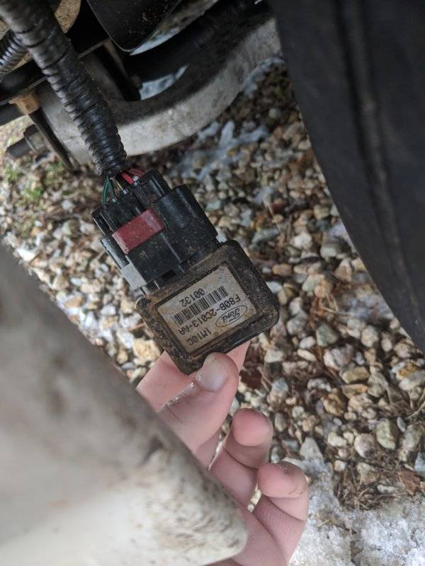

I am getting a code p1413. Is that possibly due to being hit on the driver's front fender?? I believe this is a relay for it? And it's now cracked.
Also, sorry if there is a specific way to due photos here. A forum for my other car we're supposed to use a hosting site.
Yeah, you can see that the heatsink/mounting ears are broke off.

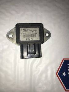

Looks like you can get them used on ebay for about $20, probably less at a local junkyard. I don't think they make them new anymore, so the few still on the shelf are pretty expensive $150ish. I think that the latest part number is F8OZ-2C013-B.
This $60 aftermarket would probably work: www.amazon.com/WVE-NTK-1R2146-Control-Relay/dp/B07DVWN6QS/ref=dp_ob_title_auto
