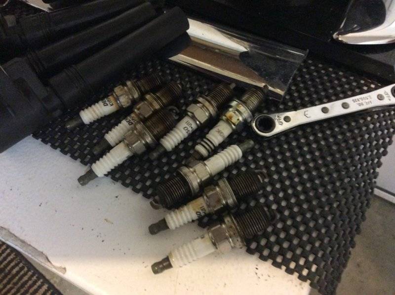

I will look into the fuel pressure ...thanks for the input Carl ...I admit I had to do a bit of modifications with the plastic fuel hose connection that connects to the bigger nozzle so I'll see if it's still holding up ....I'll be changing all cop's and plugs shortly ...I'll post update after changing them out with new

I think you were right my plugs needed replacement she seems to be starting without any trouble now
