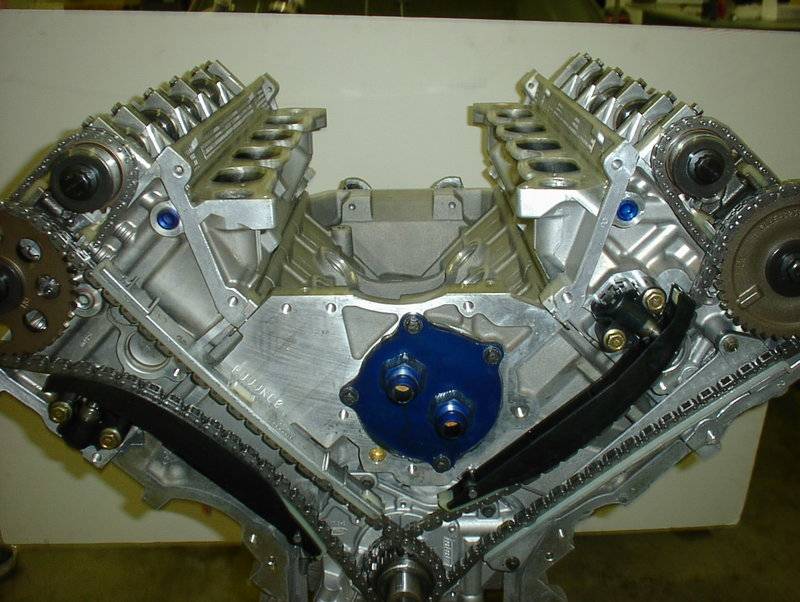

Our timing chains are 2 double roller type on each head. Both intake and exhaust cams are driven/connected by a chain. Here is a pic:
