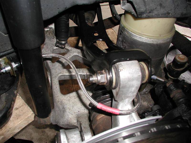

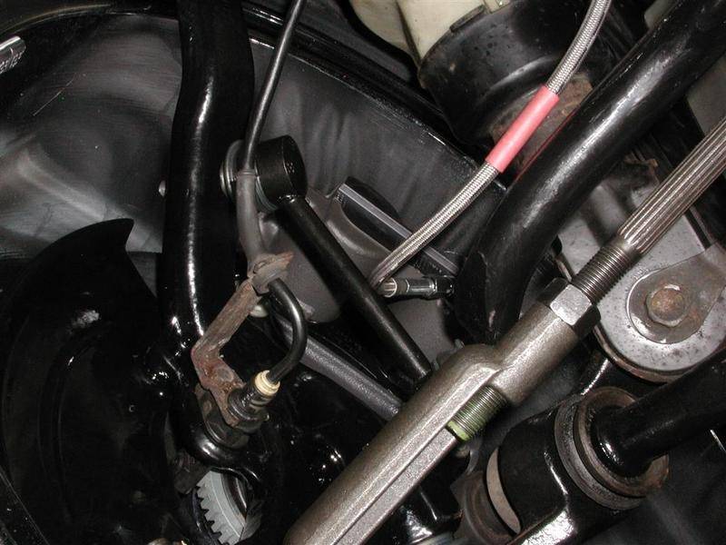

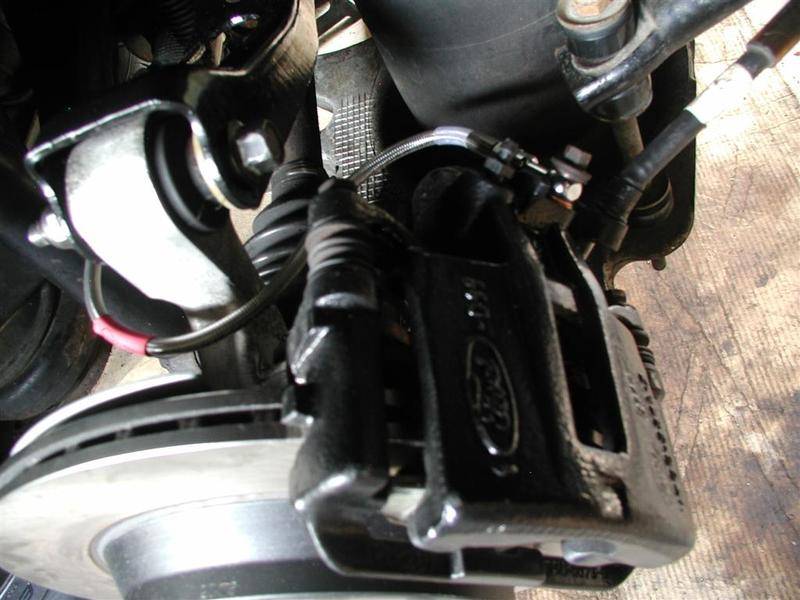

Well, all I can say is that the stainless lines that I linked to are on my car now and they work with the Cobra front calipers along with the Cobra rear rotors and are supposed to be DOT legal. Jeremi installed them so I don't have all the details on any modifications, but I believe they're pretty minor.
And yes, that ABS sensor bracket is getting replaced. ;)

Yes all you need are braided lines for a Mark VIII. There is no special line for cobra calipers. All stainless lines that I have ever seen use a universal round fitting on the caliper end. You will need to make sure you get the correct banjo bolt for your particular calipers though because they are usually not included and the stocker won't work.

Thats not exactly true. Depending what year Cobra the calipers are from the bolt may or may not work. Man I went through hell finding that out. :lol:
Anywho, these are the lines. Make sure to go to a Ford dealer and get OEM washers. Parts store ones are too thin and the banjo bolt will hit the back of the caliper. Again, more hell I went through.
