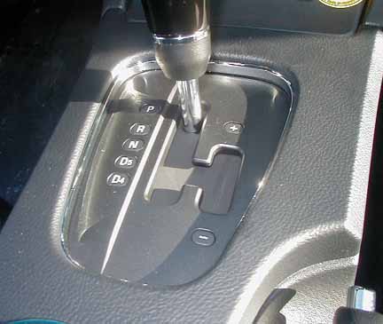

I am interested in understanding the disadvantage, if any, of linear shift over SST for my type of driving. My car has SST and I normally drive in D5 for full automatic shifting and I am not interested in the 'sporting' use of SST but occasionally want to downshift lower than D4 for engine braking on long downhill stretches.
With SST down shifting beyond D4 requires rocking the selector repeatedly until reaching the desired gear. Although I have not driven a linear shift version of this automatic I assume it is similar to conventional ones where one pull on the lever (OK, right and back) to the desired gear is all that is required. I am considering a switch to the conventional shifter and would appreciate any comments on this. I realize a session with WDS @ Ford may be required to reconfigure the PCM for the electrical signals on the new shifter. Please remember I only downshift manually for hill descent and I do not touch the shift lever for any other aspect of 'performance' driving.

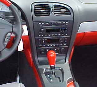

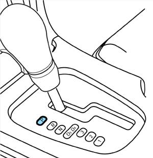

No 'Bird ever left the factory with SST. If you have it someone added it (top is SST, bottom non-SST). SST is quite helpful in mountainous driving. In SST the gear selected is the only gear available. I surmise that if you do have the shifter you can't access D4, yes? I don't think a dealer would install an LS calibration into a T-Bird; unless it was a Ford mechanic-owned 'Bird.

Interesting..... Learn something new every day. With the non-SST shifter your only option for holding a gear is 1-3. Once you engage D4 or D5 you're back in full auto mode. I drove Pikes Peak years ago using the SST. It proved quite useful up and down. One thing about the LSes manual shifting is the gear you select is all you get. It won't upshift and will just bounce off the rev limiter. If you're above 3rd when coming to a stop it will downshift to 3rd.

I believe you'll lose D4 and shifting to your present D4 position will actually get you 3rd. Remember, the PCM reads the shifter linearly; the position under D5 on the SST shifter is D4, while on the non-SST shifter it is 3rd.

Anyway, yes. The PCM won't read D4 as it reads (depending on the calibration; sport or non-sport) the shifter vertically. So in the non-sport calibration the shifter "sees" 3 directly under D5.
