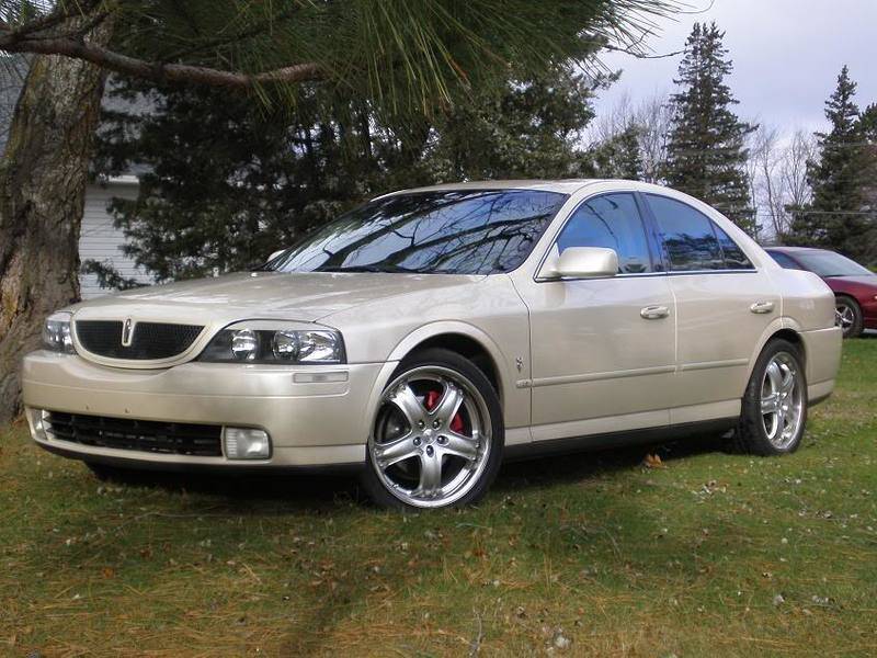

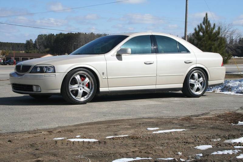

So, this is when I first got my fondmetals:
And this is how the car looks after the drop:
More pictures to follow. I have my kid with me, so I can't take a bunch. Plus, 11:30 am is terrible lighting.

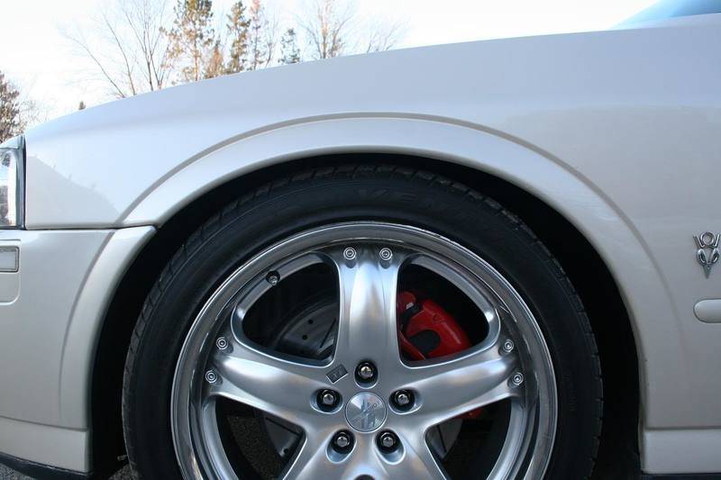

If you get any rubbing just roll that horizontal part of the inside rear fender. I used a round pry bar braced against the tire. Go slowly and take care as you don't want to bend the fender, just that horizontal section that extends into the wheel well. Also, take speed bumps slow and easy! Especially on the departure (downhill) side!

Thanks! for the compliment, and the springs! I have a 42 offset on these wheels, so hopefully I won't need to modify the fenders. Thanks for the tip, that's what I'll do if I run into issues!

Thanks everyone for the response. Before the springs, I could get 3 fingers easy between the fender and tire. Now I can't get one unless I angle my finger up.

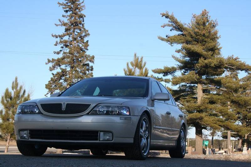

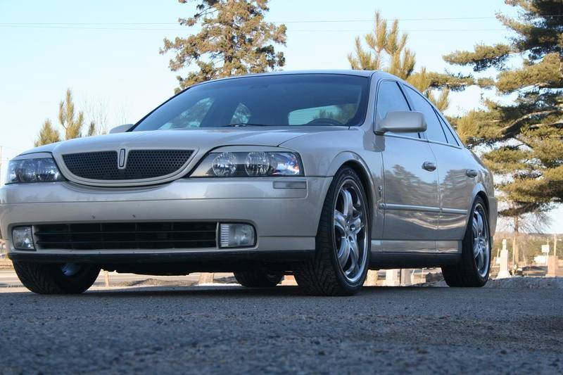

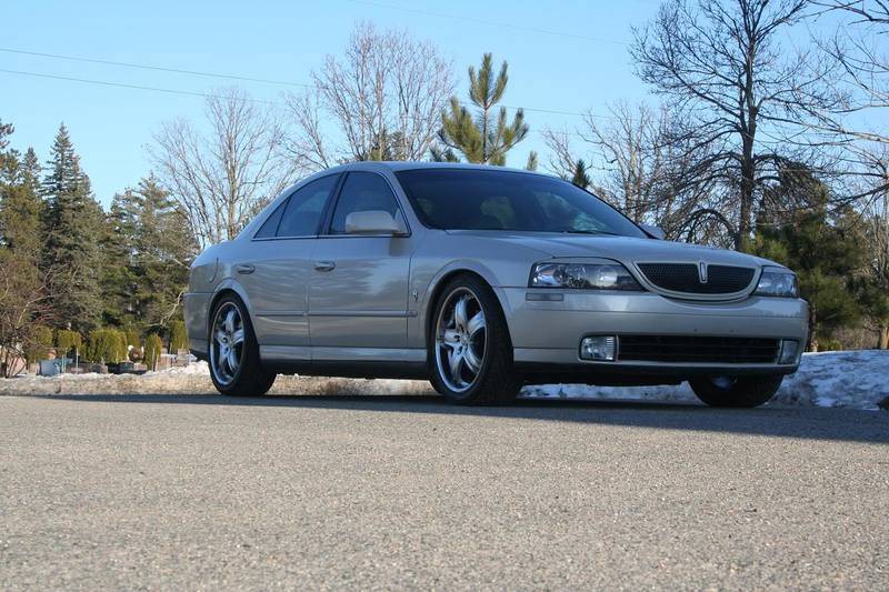

here's a couple more pictures :D
As long as you have a 7 1/2" wide wheel you should be fine. I had 18X8 1/5" Voxx with a 40mm offset when I had those on. They rubbed under extreme compression situations with a 245/45 tire. With a 245/40 tire I didn't notice any rubbing.
