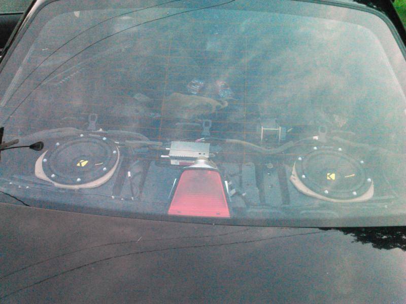

5x7 or 6x8 factory hole. I have kicker DS 5x7's in all 4 doors and the factory rear deck sub box.

Could you post a picture? I've been shopping for components to replace my stock Audiophile door speakers and knee tweeters, especially since I opted to not reconnect the tweeters to the new head unit. I've seen component tweeters mounted to the dash and think they look awful. My only problem with the mirror area is I don't want them to look tacky and out of place either
Here you go..... Once my phone finishing sending I should have a couple more...
