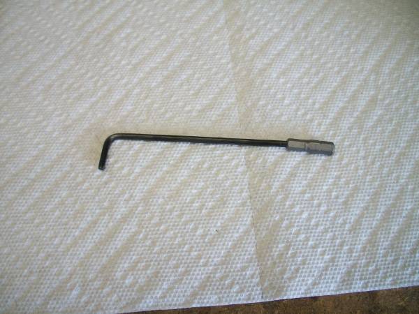

Are your spark plug wells caked with gunk? (Thank you, crappy seals!)
Want them to shine like new?
Tired of wasting time cleaning with no results?
Act fast and get the Super Wham-O Well Cleaner!
I grabbed an allen wrench where the short end just fits into the well and a "security" hex drive with a hole in the middle that slightly too small to fit the allen. Grind the edges of the wrench just a little, add some persuasion with a large hammer to get the wrench into the hole, and voila! Tool!
Wrap some paper towels around it, put a ratchet drive on it, stick in the hole, swirl it around, all the gunk comes out!
Difficulty: Easy
Benefit: Shiny wells
