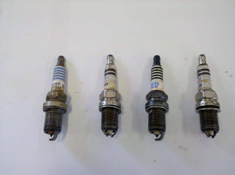

Well i noticed in the last few weeks i've been smelling fuel. Then shortly afterwards the check engine light came on (good thing i ordered a CarMD it came in handy). I got a code saying one of my O2 sensor was bad so i changed it out and the code went away. So i week later i get the idea to attempt to change my spark plugs and coils out since the last time it was done was 2006 before my car went into storage for three years. of course the stealership wants over $1000 including parts and firestone wanted about $800 with parts. well good thing for this site because i got the balls to do it myself today. it took me about three hours to do both sides. as you can see from the pics there are three different name spark plugs (autolite, bosch and motorcraft) inside and boy was i pissed. the hardest one to get to (driver side rear) looked like it was the original plug and was fouled. Altman Lincoln Mercury (closed down a year after this flailex) completed this disaster. Screw dealerships!
