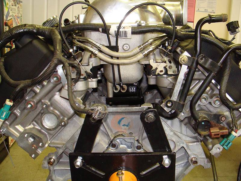

Anyone know where to go to from here? I've done seafoam within the last year but haven't gotten behind the heads to try to move that IMRC plate actuator... gunna try tomorrow.
Whoa... so that's where those IMRC's are.

Got my hand behind the passenger side and moved the IMRC plate.. couldn't get behind on the drivers side... I'll have to take the cowl off first.
