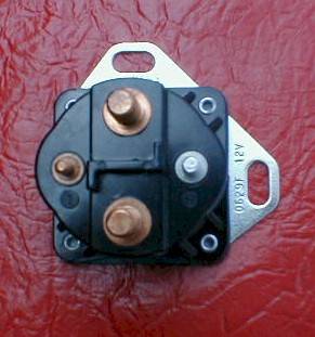

Follow your positive battery cable to the solenoid. If thats what's ticking, then it probably needs replaced. First make sure the 2 bigger wires attached to it are clean and tight. Make sure your battery cable is clean and tight. If you go to start it and it clicks, you can turn on the ignition and take a screwdriver and "jump" the two larger terminals on the solenoid. If it starts, the solenoid is bad. It's very straight forward to replace. Just make sure the wires go back on in the right places and unhook the battery first.
It'll look something like this:
BTW, jumping the solenoid is also a good solution to being stuck somewhere with a car that won't start...If the solenoid is the problem. It's a very common thing. I drove an F-350 that I started with a screwdriver for a week.
Ya thats what my friend had to do to start it once. So i guess thats it. Ill just replace it. Thanks a lot guys!
