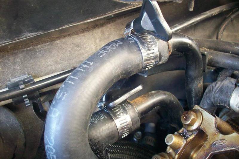

For a Gen2 ...
1) Is the top hose in the image above the heater inlet hose ?

Is the top hose the heater inlet hose ?

I'm not going to cut the heater inlet host as described in the Prestone instructions. I'm going to disconnect the heater inlet hose from the engine, temporarily attach the T connector at the end and then connect a small piece of 3/4" hose to the T connector and engine. After the flush is done, I'll remove the T connector and small piece of hose and reattach the heater inlet hose to the engine.
I just need to confirm if the heater inlet hose, pictured above, is the one on top ?

The lower hose carries hot coolant from the passenger side head to the heater core. The upper hose carries coolant from the heater core to the backside of the water pump. The "heater inlet hose" would be the lower hose.
