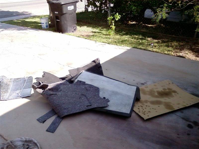

and i needed to clean my car...............and lost like 10lbs worth of insulation crap.........free mod!!! lol ^_^

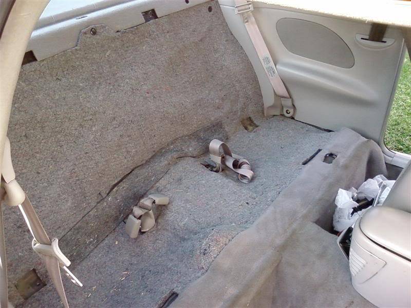

1. remove rear seat........youre greeted with this:
ewwwwwwwwww.........id never seen a car with that much stuff behind the rear seat before -_-
2. remove all that stuff..........
better......hey theres more stuff to remove from the trunk side.........

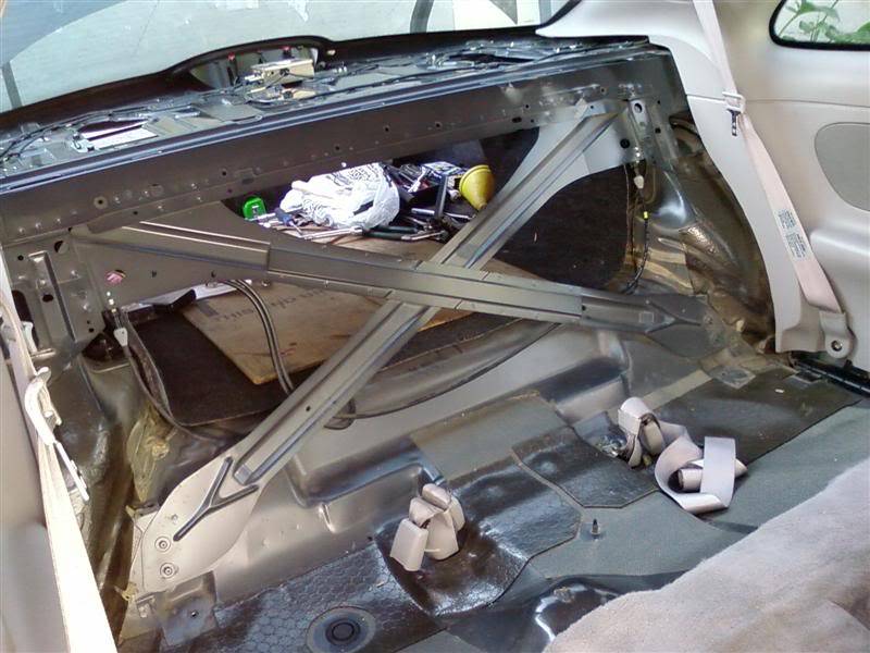

3. remove trunk plastic that covers the X brace/amp tray.........
look at all the crap i had on my trunk.......its now CLEAN though :)

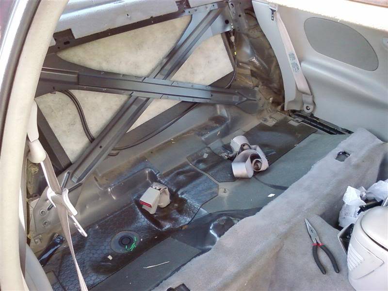

4. remove rear deck panel, just pull from one side itll come out.......and theres MORE insulating stuff........remove ^_^
ahhhhh.......much better raw look that i prefer........under the hood i removed all the plastic covers a long time ago ^_^ ...........

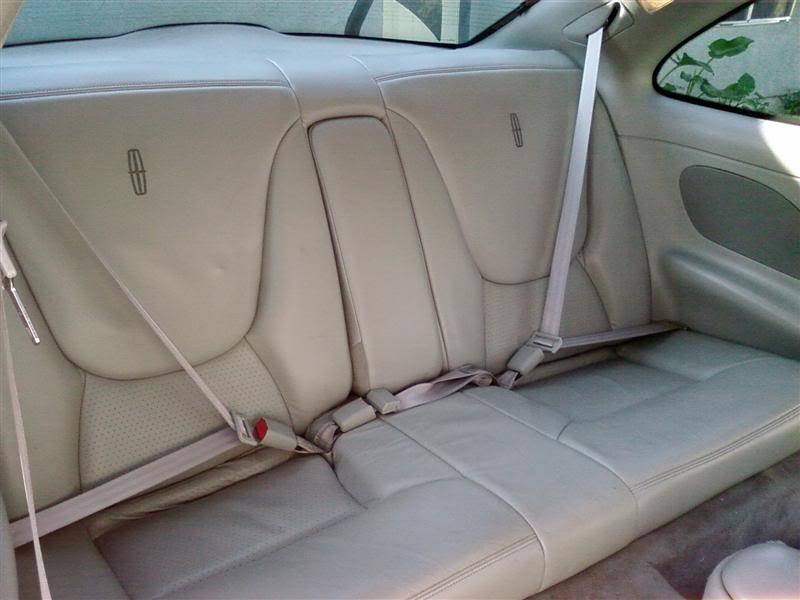

5. now put everything back together...........
tada!!!......... ^_^
6. and u end up with this outside...........
just a weee bit more ambient noise now.......feels more open now that the only thing in between the trunk and pass. compartment is the seat itself..........oh and a clean trunk......i had lot of tools back there.......so its even lighter now........tehehehe ^_^

i wouldnt drill anything on that brace........its so flimsy :( , i could move it at least 1/4 inch in the middle with my hand lolol..........pretty thin metal.

Careful with that brace- you have an air line running against it.
chassis flex caused one of those braces to break on mine. The broken tab cut the air ride line that was there. It was quite a pain in the but because it wasn't an obvious diagnosis when my air ride failed.
I had a nasty rattle on my 95 and it ended up that brace on the pass side lower was never even bolted on, there was a single plastic alignment pin of some kind instead of two bolts.
