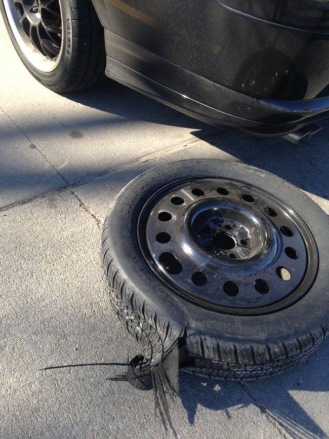

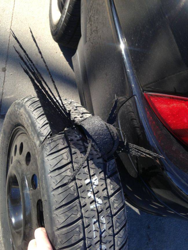

This actually happened a few weeks ago and thought this was crazy.
I was cruising home from work one afternoon with the music up and in some heavy traffic. While driving I hear BOOM! I instantly turn the music down and am looking all over to see what is going on, holding tightly to the steering wheel and seeing if the car is ok, if there was a wreck or someone actually shooting out his road rage etc!! I thought I may have had a blow out also...and I did but not on the driving tires.
After getting home and everything checking out seeming ok I blew the incident out of my mind. Well, a couple weeks ago I'm cleaning out the car and get into the trunk and find my spare totally blown out!! ah ha!!
I've had this LS pushing close to 3 years already and have never used the donut. The tread on the tire still has the nubbies on it and aside from the gapping hole looks factory fresh. I've never had this happen before. :eek:

You are not the first. There are other tales of exploded LS spare tires. This is one of the reasons that I dumped the mini-spares from both of my LSes. (I got some LS wheels off of e-bay, and I now have full sized spares.) I think that any tire over six years old is suspect and any tire over ten years old must be changed.
That's what my spare looks like LMFAO. I bought the car just over a year ago. Few days after the purchase I notice the spare looking like that. And to this day have wondered what the hell happened to it. Thanks for the post.
Well, if there are mutiple stories that doesn't give me much confidence in the donut spare I picked up from the salavge yard!! :p
I'll have to pick up a full size as well!

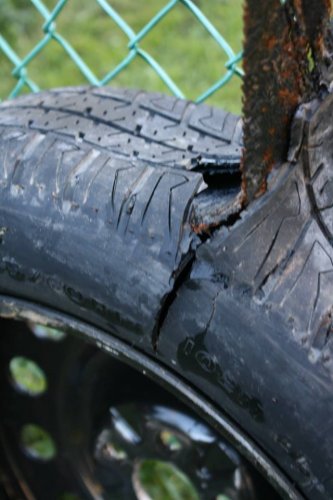

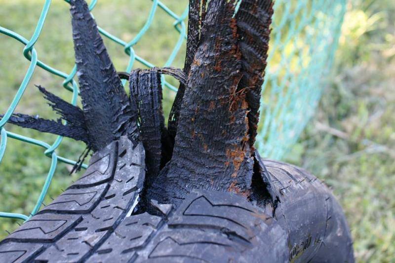

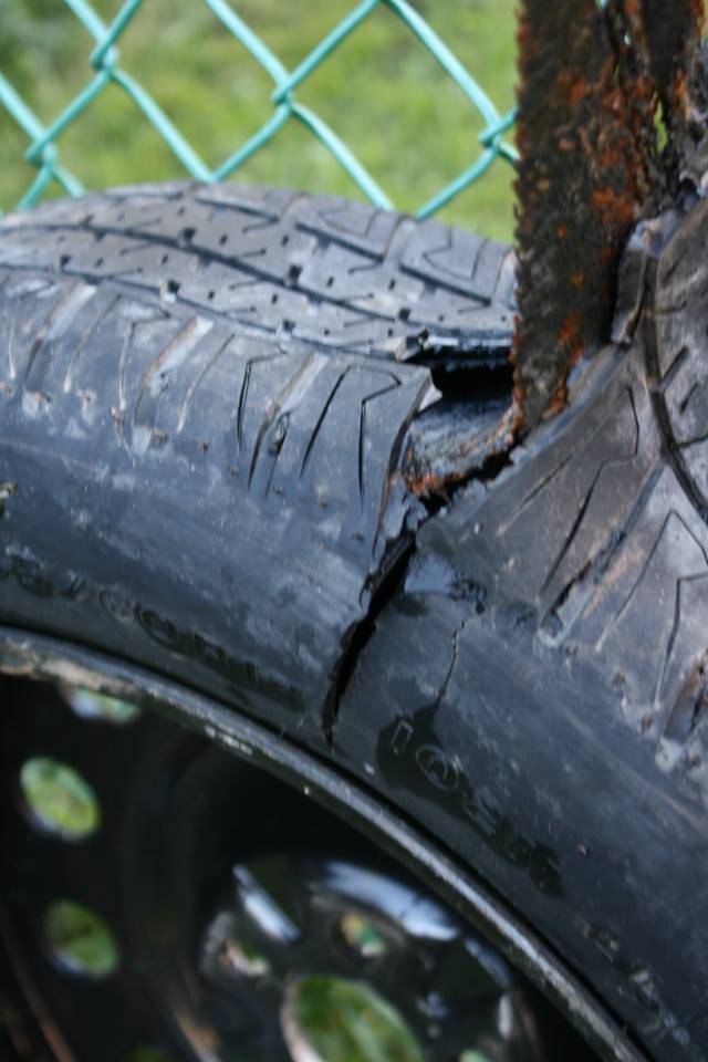

I found mine like that, i had never used it and then I went to check it one day and it looked like this. It must have happened when I was not in the car because I heard nothing
thats wild this has happened so many times (just with our small pool of LS owners)...
wonder if it rubs somewhere in the cradle?

I wonder if it relates to moisture in the tire well and/or unvented aftermarket batteries?
I suspect that Kumba's comment about the tire being designed for only 50 miles of use is a big factor.
They say right on them "For temporary use only". Design spec is 50 miles at 55mph. Even then it will be less if it's on the front (steering) end of a car. They are really on to be used when you have a tire blow-out. If you just got a slow leak you are better off pumping the tire up and taking it to a shop. That's why I keep a small portable air compressor in the trunk. Almost all the tire issues I've had were small slow leaks from things like nails or whatever got stuck in the tire.
If you do have to use the spare for more then just a few blocks I would move it to the back of the car. Those things are squirrely on the front of a car at best.
The spare in my car is still in seemingly good shape from what I can tell. It does rub against the tire well at the front which might explain why they fail. Years of vibration might just cause the plys to separate and eventually blow out.

I'd say that what usually happens is by the time you use a spare tire it's so old and dry rotted that it's essentially a use once throw away. That's been my experience every time I've used one anyways. They were garbage by the time I got to the tire shop. Then again these are spares that have been in the car for years before I used them.
The sad part is that the spare tire itself aren't that cheap. They're anywhere from $60 to $100. A full size el-cheapo tire is around the same price, minus the cost of some sort of rim that'll fit on the car.
I bought two (one for each car) full size rims off of e-bay. Then, the next time that I needed new tires, I had them swap the best of the old tires to the e-bay rims to use as spares.
