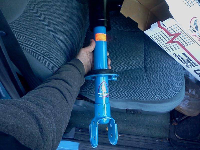

Very cool. Have any pics? Where'd you get them?
I bought them from a member on another forum because at the time, there was no availability of these shocks. I would just search online for them. I would imagine by now they are available again, but before you make any potential purchase and get the "sorry we don't actually have them" type of email that I got(even though they said they were in stock:rolleyes:) I would call them on the phone to verify. Sometimes these online sites are very disorganized with their inventories. Just a fair warning....
