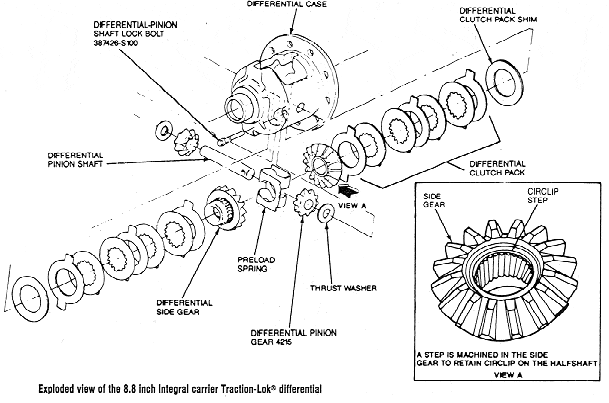

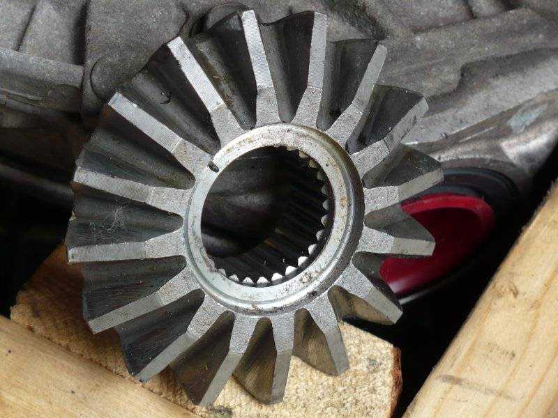

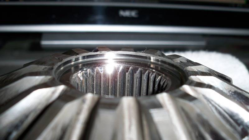

There is no grove either.
Its a 30 degree taper on the inside edge of the Splines of the spider gears. Any one with a Lathe could get it done in a few minutes.
there is a step as in this pic
